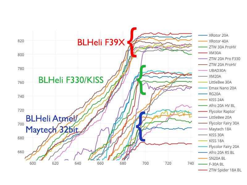

It was always my goal to find a high KV motor with decent amp draw and high RPMs that would really put some pressure on the hardware.  I really found that with the RotorGeeks 2205 2700kv motor combined with the HQProp 4x4BN propeller.  This combination hits over 35000 RPMs and over 20A on the high end.  35,000 RPMs on a 14 pole motor at 245,000 eRPMs is right up to the 250,000 eRPM limiter point in BLHeli for the Silabs F330 and F840 ESCs, as well as the Atmels. The goal was to show if the MCU becomes a limiting factor and find where the limits of the various ESCs lie. This test certainly fullfilled those requirements.  This was one of the longest and most problematic ESC tests I've run to date!  About half way through the first run of data, the prop started deflecting on the high throttle ESCs and I didn't notice till I was reviewing the data.  This meant I had to entirely redo about half the ESCs. This combintion REALLY pushed the hardware. In the process of this test I've blown 5 ESCs (2 LittleBees, a KISS 18A, a KISS24A, and an SN20A) for various reasons, ranging from firmware issues to sync loss, to hardware failure (SN20A anyone?). I started out running the tests at 3.8khz refresh rate (260us looptime), but that ended up being too much for the slower MCUs combined with the high output RPMs.  In the process Steffen added some high RPM optimizations on the F330s in BLHeli and released v14.4, and Felix found an issue with the firmware in the new KISS 24A related to high (>3.5khz) refresh rates.  It was good to see active testing solving real problems and contributing to moving things forward!

The RG20 Plus is essentially identical to the original RG20 except for the upgraded F396 MCU instead of the F330.  Performance is on par with the other F39X series ESCs.  One thing to note is that I do not have a BLHeli 14.4 binary for this, so the results posted here are on 14.5.  I've notice some thrust variations on 14.5 vs 14.4 with this particular motor, so the RG20A Plus may be slightly under-rated in this test.  I will see if I can get a 14.4 binary from Steffen and re-run it so I'm comparing apples to apples.

Now the GOOD news! BLHeli_S is epicly smooth!  The idle is just nuts, and the rough startup traditional with BLHeli is utterly gone!  I was a tad disappointed in the top end, as it was still 30g or so under the XRotor 40A.  To be fair it still scored almost even with the LittleBee 30A and the UBAD 30A, so all things considered it's still a win in my book. There may also be further optimizations in the firmware, but time will tell. Overall I am EXTREMELY pleased.  The results are updated above with the SEMF.  I still have to run the second order metrics for braking, etc, as well as for the other ESCs I recently added, but I'll get to those soon.  That will provide some interesting additional information.  For now, enjoy this video of the test run, and the sound of smoothness!
